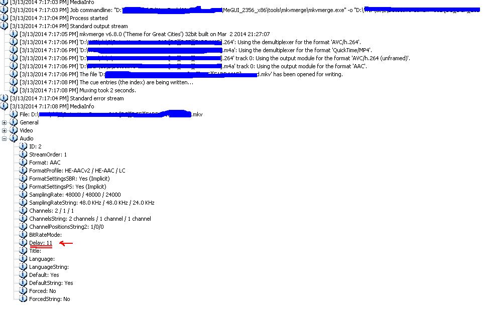

  1. Ok, so everytime i encode videos, the output would always have a delay of around 10-12ms...
    it is stated in the MeGUI Log Tab as well as in Mediainfo Text Mode
    My previous encodes (which was last 2012) never had an added delay when i checked them in mediainfo.
    I found this out when i decided to re-encode the same videos as they had low bitrates, then i noticed this "delay" which wasn't present
    in my previous encodes.
    Btw, i use "AutoEncode" feature for both my past and present encodes instead of manually merging the files with mmg....

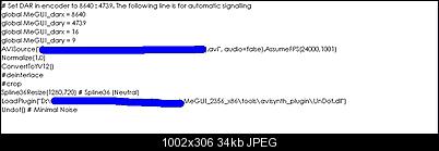

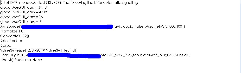

    Here's my avisynth script if it helps

    *added avisynth script screenshot

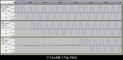

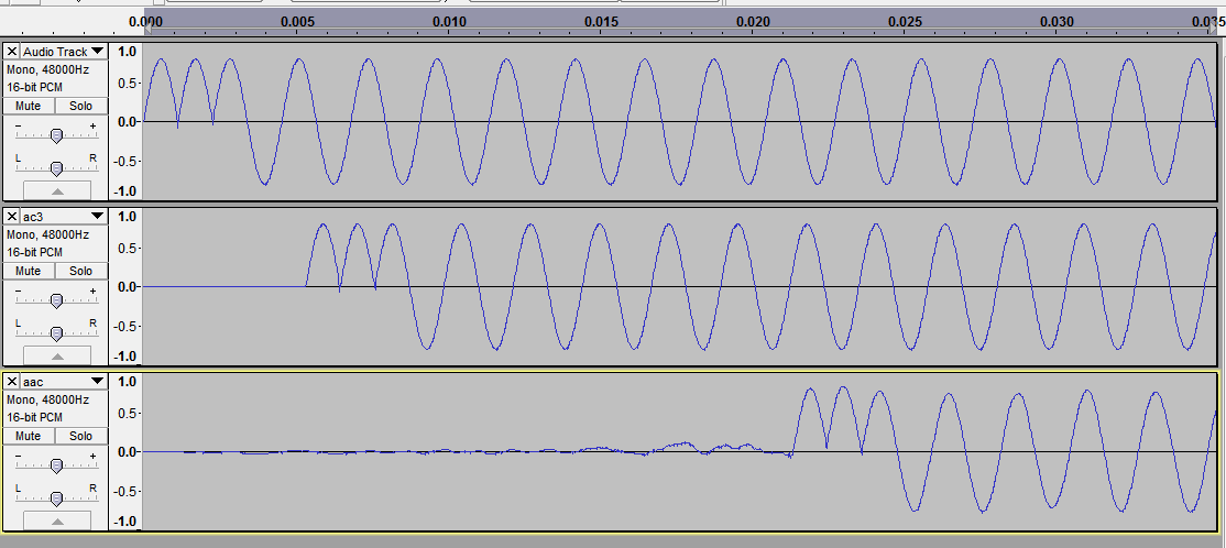

  6. I don't know if this has anything to do with your issues, but high compression audio codecs typically add a short bit of silence when encoding:
    The top waveform is the original. The middle is ac3, the bottom aac.
